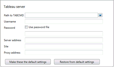

Monarch Classic now supports exports to and updates of existing worksheets in Tableau Server. Access to Tableau Server may be configured through the Security tab of the Options window.
The following items must be supplied to establish a connection to Tableau Server.
Field
Path to TABCMD
The folder in which TABCMD, a command line utility supplied by Tableau that performs various operations in Tableau Server, is installed.
Note: This utility must be installed to access Tableau Server.
Username
The username of a person accessing Tableau Server
Password
The password of this user
Server address
The URL of Tableau Server
Site
The site to be accessed in Tableau Server
Proxy Address
The IP of your proxy server if you are using one

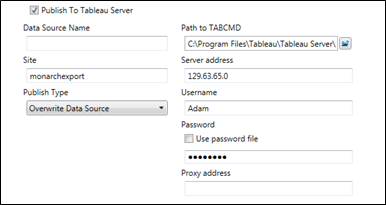

  3. Check the box for Publish to Tableau Server.
    The information you entered to access Tableau Server in the Security tab of the Options window displays. If you did not provide the necessary information in this tab, you can do so now.
  4. Enter a data source name into the field provided and select a publish type.
    • Overwrite Data Source - This option will erase the existing data source and replace it with a new one containing the newly exported data.
    • Replace Data - This option will erase all previous data in the data source and replace it with the newly exported data.
    • Append Data - This option will append the newly exported data to the data in the existing data source.
