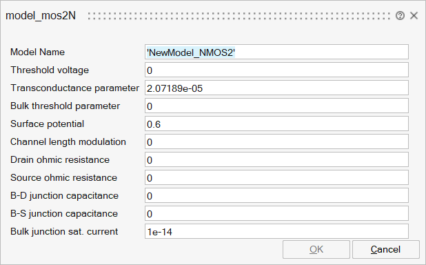

model_mos2N
Level 2 MOSfet model with Meyer capacitance model redefinition
Spice/Analog/Basic/models
.model definitionParameters
