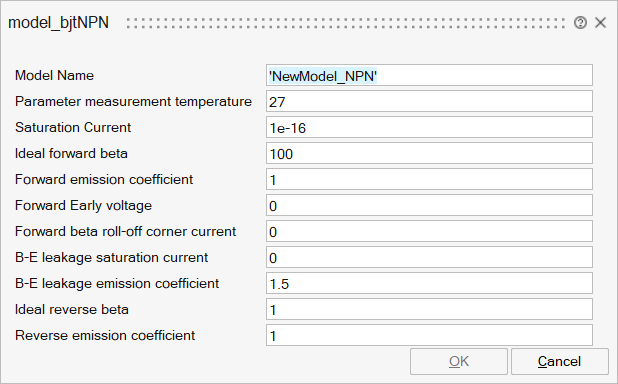

model_bjtNPN
Bipolar Junction Transistor redefinition
Spice/Analog/Basic/models
.model definitionParameters
sp_mname | Model Name | The model name of the new model that the user wants to create | String | |
sp_NPN | NPN | String | ||
sp_tnom | Parameter measurement temperature | Scalar | ||
sp_is | Saturation Current | Scalar | ||
sp_bf | Ideal forward beta | Scalar | ||
sp_nf | Forward emission coefficient | Scalar | ||
sp_vaf | Forward Early voltage | Scalar | ||
sp_ikf | Forward beta roll-off corner current | Scalar | ||
sp_ise | B-E leakage saturation current | Scalar | ||
sp_ne | B-E leakage emission coefficient | Scalar | ||
sp_br | Ideal reverse beta | Scalar | ||
sp_nr | Reverse emission coefficient | Scalar | ||
sp_var | Reverse Early voltage | Scalar | ||
sp_ikr | reverse beta roll-off corner current | Scalar | ||
sp_isc | B-C leakage saturation current | Scalar | ||
sp_nc | B-C leakage emission coefficient | Scalar | ||
sp_rb | Zero bias base resistance | Scalar | ||
sp_irb | Current for base resistance=(rb+rbm)/2 | Scalar | ||
sp_rbm | Minimum base resistance | Scalar | ||
sp_re | Emitter resistance | Scalar | ||
sp_rc | Collector resistance | Scalar | ||
sp_cje | Zero bias B-E depletion capacitance | Scalar | ||
sp_vje | B-E built in potential | Scalar | ||
sp_mje | B-E junction grading coefficient | Scalar | ||
sp_tf | Ideal forward transit time | Scalar | ||
sp_xtf | Coefficient for bias dependence of TF | Scalar | ||
sp_vtf | Voltage giving VBC dependence of TF | Scalar | ||
sp_itf | High current dependence of TF | Scalar | ||
sp_ptf | Excess phase | Scalar | ||
sp_cjc | Zero bias B-C depletion capacitance | Scalar | ||
sp_vjc | B-C built in potential | Scalar | ||
sp_mjc | B-C junction grading coefficient | Scalar | ||
sp_xcjc | Fraction of B-C cap to internal base | Scalar | ||
sp_tr | Ideal reverse transit time | Scalar | ||
sp_cjs | Zero bias Substrate capacitance | Scalar | ||
sp_vjs | Substrate junction built in potential | Scalar | ||
sp_mjs | Substrate junction grading coefficient | Scalar | ||
sp_xtb | Forward and reverse beta temp. exp. | Scalar | ||
sp_eg | Energy gap for IS temp. dependency | Scalar | ||
sp_xti | Temp. exponent for IS | Scalar | ||
sp_fc | Forward bias junction fit parameter | Scalar | ||
sp_iss | Substrate Jct. Saturation Current | Scalar | ||
sp_ns | Substrate current emission coefficient | Scalar | ||
sp_tlev | Temperature equation selector | Scalar | ||
sp_tlevc | Temperature equation selector | Scalar | ||
sp_tbf1 | BF 1. temperature coefficient | Scalar | ||
sp_tbf2 | BF 2. temperature coefficient | Scalar | ||
sp_tbr1 | BR 1. temperature coefficient | Scalar | ||
sp_tbr2 | BR 2. temperature coefficient | Scalar | ||
sp_tikf1 | IKF 1. temperature coefficient | Scalar | ||
sp_tikf2 | IKF 2. temperature coefficient | Scalar | ||
sp_tikr1 | IKR 1. temperature coefficient | Scalar | ||
sp_tikr2 | IKR 2. temperature coefficient | Scalar | ||
sp_tirb1 | IRB 1. temperature coefficient | Scalar | ||
sp_tirb2 | IRB 2. temperature coefficient | Scalar | ||
sp_tnc1 | NC 1. temperature coefficient | Scalar | ||
sp_tnc2 | NC 2. temperature coefficient | Scalar | ||
sp_tne1 | NE 1. temperature coefficient | Scalar | ||
sp_tne2 | NE 2. temperature coefficient | Scalar | ||
sp_tnf1 | NF 1. temperature coefficient | Scalar | ||
sp_tnf2 | NF 2. temperature coefficient | Scalar | ||
sp_tnr1 | NR 1. temperature coefficient | Scalar | ||
sp_tnr2 | NR 2. temperature coefficient | Scalar | ||
sp_trb1 | RB 1. temperature coefficient | Scalar | ||
sp_trb2 | RB 2. temperature coefficient | Scalar | ||
sp_trc1 | RC 1. temperature coefficient | Scalar | ||
sp_trc2 | RC 2. temperature coefficient | Scalar | ||
sp_tre1 | RE 1. temperature coefficient | Scalar | ||
sp_tre2 | RE 2. temperature coefficient | Scalar | ||
sp_trm1 | RBM 1. temperature coefficient | Scalar | ||
sp_trm2 | RBM 2. temperature coefficient | Scalar | ||
sp_tvaf1 | VAF 1. temperature coefficient | Scalar | ||
sp_tvaf2 | VAF 2. temperature coefficient | Scalar | ||
sp_tvar1 | VAR 1. temperature coefficient | Scalar | ||
sp_tvar2 | VAR 2. temperature coefficient | Scalar | ||
sp_ctc | CJC temperature coefficient | Scalar | ||
sp_cte | CJE temperature coefficient | Scalar | ||
sp_cts | CJS temperature coefficient | Scalar | ||
sp_tvjc | VJC temperature coefficient | Scalar | ||
sp_tvje | VJE temperature coefficient | Scalar | ||
sp_tvjs | VJS temperature coefficient | Scalar | ||
sp_titf1 | ITF 1. temperature coefficient | Scalar | ||
sp_titf2 | ITF 2. temperature coefficient | Scalar | ||
sp_ttf1 | TF 1. temperature coefficient | Scalar | ||
sp_ttf2 | TF 2. temperature coefficient | Scalar | ||
sp_ttr1 | TR 1. temperature coefficient | Scalar | ||
sp_ttr2 | TR 2. temperature coefficient | Scalar | ||
sp_tmje1 | MJE 1. temperature coefficient | Scalar | ||
sp_tmje2 | MJE 2. temperature coefficient | Scalar | ||
sp_tmjc1 | MJC 1. temperature coefficient | Scalar | ||
sp_tmjc2 | MJC 2. temperature coefficient | Scalar | ||
sp_tmjs1 | MJS 1. temperature coefficient | Scalar | ||
sp_tmjs2 | MJS 2. temperature coefficient | Scalar | ||
sp_tns1 | NS 1. temperature coefficient | Scalar | ||
sp_tns2 | NS 2. temperature coefficient | Scalar | ||
sp_nkf | NKF High current beta rolloff exponent | Scalar | ||
sp_tis1 | IS 1. temperature coefficient | Scalar | ||
sp_tis2 | IS 2. temperature coefficient | Scalar | ||
sp_tise1 | ISE 1. temperature coefficient | Scalar | ||
sp_tise2 | ISE 2. temperature coefficient | Scalar | ||
sp_tisc1 | ISC 1. temperature coefficient | Scalar | ||
sp_tisc2 | ISC 2. temperature coefficient | Scalar | ||
sp_vbe_max | maximum voltage B-E junction | Scalar | ||
sp_vbc_max | maximum voltage B-C junction | Scalar | ||
sp_vce_max | maximum voltage C-E branch | Scalar | ||
sp_Spice | Additional Spice Parameters | String |
