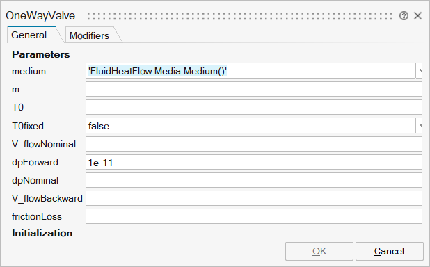

Simple one-way valve, comparable to the electrical ideal diode model.
- from flowPort_a to flowPort_b: small pressure drop, linearly dependent on volumeFlow
- from flowPort_b to flowPort_a: small leakage flow, linearly dependent on pressure drop
mo_medium | medium | Medium in the component | FromModelica('Modelica.Thermal.FluidHeatFlow.Media.Medium') | |
mo_m | m | Mass of medium | Scalar | |
mo_T0 | T0 | Initial temperature of medium | Scalar | |
mo_T0fixed | T0fixed | Initial temperature guess value or fixed | Scalar | true |
mo_tapT | tapT | Defines temperature of heatPort between inlet and outlet temperature | Scalar | |
mo_V_flowNominal | V_flowNominal | Nominal volume flow rate (forward) | Scalar | |
mo_dpForward | dpForward | Pressure drop at nominal flow (forward) | Scalar | |
mo_dpNominal | dpNominal | Nominal pressure (backward) | Scalar | |
mo_V_flowBackward | V_flowBackward | Leakage volume flow rate (backward) | Scalar | |
mo_frictionLoss | frictionLoss | Part of friction losses fed to medium | Scalar | |

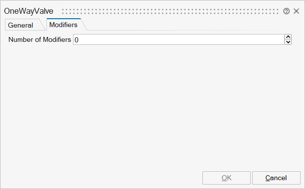

mo__modifiers/varname | Variable name | Cell of strings | 'dp' | |
mo__modifiers/value | Value |
