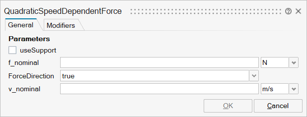

Model of force, quadratic dependent on velocity of flange.
Parameter ForceDirection chooses whether direction of force is the same in both directions of movement or not.
mo_useSupport | useSupport | = true, if support flange enabled, otherwise implicitly grounded | Number | 0 |
mo_f_nominal | f_nominal | Nominal force (if negative, force is acting as load in positive direction of motion) | Scalar | |
mo_ForceDirection | ForceDirection | Same direction of force in both directions of motion | Scalar | true |
mo_v_nominal | v_nominal | Nominal speed | Scalar |

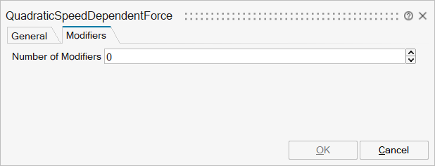

mo__modifiers/varname | Variable name | Cell of strings | 's' | |
mo__modifiers/value | Value |
