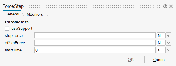

Model of a force step at time startTime.Positive force accelerates in positive direction of flange translation.
mo_useSupport | useSupport | = true, if support flange enabled, otherwise implicitly grounded | Number | 0 |
mo_stepForce | stepForce | Height of force step (if negative, force is acting as load) | Scalar | |
mo_offsetForce | offsetForce | Offset of force | Scalar | |
mo_startTime | startTime | Force = offset for time < startTime | Scalar |

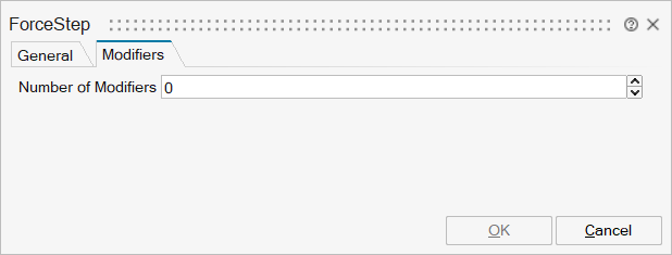

mo__modifiers/varname | Variable name | Cell of strings | 's' | |
mo__modifiers/value | Value |
