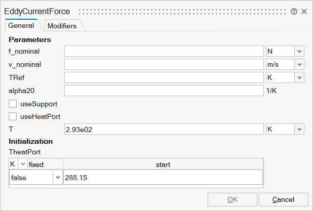

This is a simple model of a translational eddy current brake. The force versus speed characteristic is defined by Kloss' equation.
Thermal behaviour:
The resistance of the braking fin is influenced by the actual temperature Theatport, which in turn shifts the speed v_nominal at which the (unchanged) maximum torque occurs.
If the heatPort is not used (useHeatPort = false), the operational temperature remains at the given temperature T.
However, the speed v_nominal at which the maximum torque occurs is adapted from reference temperature TRef to the operational temperature.
mo_f_nominal | f_nominal | Maximum force (always braking) | Scalar | |
mo_v_nominal | v_nominal | Nominal speed (leads to maximum force) at reference temperature | Scalar | |
mo_TRef | TRef | Reference temperature | Scalar | |
mo_alpha20 | alpha20 | Temperature coefficient of material | Scalar | |
mo_useSupport | useSupport | = true, if support flange enabled, otherwise implicitly grounded | Number | 0 |
mo_useHeatPort | useHeatPort | = true, if heatPort is enabled | Number | 0 |
mo_T | T | Fixed device temperature if useHeatPort = false | Scalar | |
mo_TheatPort | TheatPort | TheatPort | Structure | |
mo_TheatPort/fixed | fixed | Cell of scalars | true | |
mo_TheatPort/start | start | Cell of scalars |

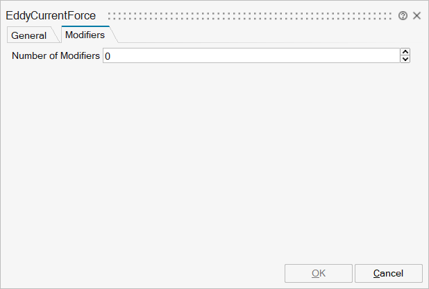

mo__modifiers/varname | Variable name | Cell of strings | 's' | |
mo__modifiers/value | Value |
flange | implicit | Flange of component | output | 1 |
Port 2 | implicit | Support/housing of component | input | mo_useSupport |
Port 3 | implicit | Optional port to which dissipated losses are transported in form of heat | input | mo_useHeatPort |
