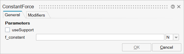

mo_useSupport | useSupport | = true, if support flange enabled, otherwise implicitly grounded | Number | 0 |
mo_f_constant | f_constant | Nominal force (if negative, force is acting as load in positive direction of motion) | Scalar |
mo__modifiers/varname | Variable name | Cell of strings | 's' | |
mo__modifiers/value | Value |
flange | implicit | Flange of component | output | 1 |
Port 2 | implicit | Support/housing of component | input | mo_useSupport |
