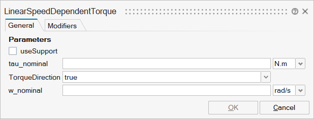

Model of torque, linearly dependent on angular velocity of flange.
Parameter TorqueDirection chooses whether direction of torque is the same in both directions of rotation or not.
mo_useSupport | useSupport | = true, if support flange enabled, otherwise implicitly grounded | Number | 0 |
mo_tau_nominal | tau_nominal | Nominal torque (if negative, torque is acting as load in positive direction of rotation) | Scalar | |
mo_TorqueDirection | TorqueDirection | Same direction of torque in both directions of rotation | Scalar | true |
mo_w_nominal | w_nominal | Nominal speed | Scalar |

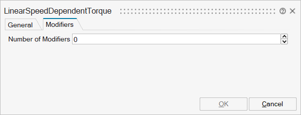

mo__modifiers/varname | Variable name | Cell of strings | 'phi_support' | |
mo__modifiers/value | Value |
