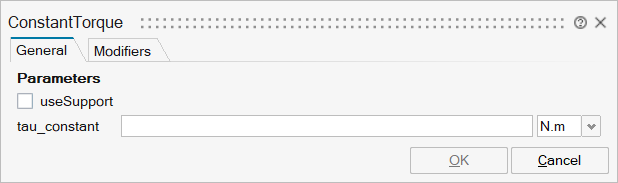

ConstantTorque
Constant torque, not dependent on speed
Modelica/Mechanics/Rotational/Sources
Model of constant torque, not dependent on angular velocity of flange.
Please note:
Positive torque accelerates in positive direction of rotation, but brakes in reverse direction of rotation.
Negative torque brakes in positive direction of rotation, but accelerates in reverse direction of rotation.
mo_useSupport | useSupport | = true, if support flange enabled, otherwise implicitly grounded | Number | 0 |
mo_tau_constant | tau_constant | Constant torque (if negative, torque is acting as load in positive direction of rotation) | Scalar |
mo__modifiers/varname | Variable name | Cell of strings | 'phi_support' | |
mo__modifiers/value | Value |
