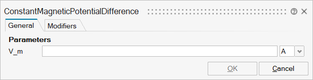

Magnetic circuits under steady-state conditions, i.e., with stationary magnetic fields (change of magnetic flux dΦ/dt = 0) can be described with constant sources of a magnetic potential difference or magnetomotive force (mmf). Constant magnetic potential differences are imposed by
- coils with stationary current (di / dt = 0) and
- permanent magnets modelled with Thévenin's equivalent magnetic circuit.
For modelling of reluctance actuators with this source component it is assumed that the armature is fixed so that no motion-induced flux change dΦ/dt can occur.
| mo_V_m | V_m | Magnetic potential difference | Scalar |

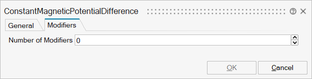

| mo__nmodifiers | Number of Modifiers | Specifies the number of modifiers | Number | |
| mo__modifiers | Modifiers | Add new modifier | Structure | |
| mo__modifiers/varname | Variable name | Cell of strings | 'Phi' | |
| mo__modifiers/attribute | Attribute | Cell of strings | 'start' | |
| mo__modifiers/value | Value |
