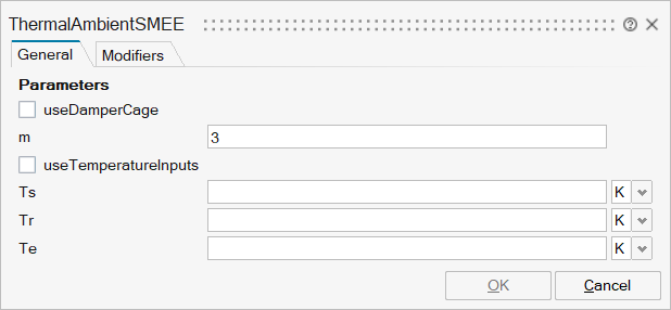

Thermal ambient for synchronous machines with electrical excitation to prescribe winding temperatures either constant or via signal connectors.Additionally, all losses = heat flows are recorded.Parameters
mo_useDamperCage | useDamperCage | Enable / disable damper cage | Number | 0 |
mo_m | m | Number of stator phases | Scalar | |
mo_useTemperatureInputs | useTemperatureInputs | If true, temperature inputs are used; else, temperatures are constant | Number | 0 |
mo_Ts | Ts | Temperature of stator windings | Scalar | |
mo_Tr | Tr | Temperature of damper cage (optional) | Scalar | |
mo_Te | Te | Temperature of excitation | Scalar |

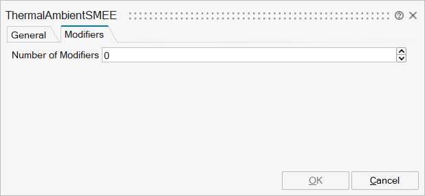

mo__modifiers/varname | Variable name | Cell of strings | 'Q_flowStatorWinding' | |
mo__modifiers/value | Value |
