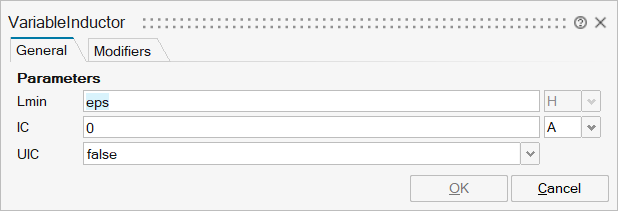

Besides the Lmin parameter the inductor model has got the two parameters IC and UIC that belong together. With the IC parameter the user can specify an initial value of the current that flows through the inductor.
Hence the inductor has an initial current at the beginning of the simulation. The other parameter UIC is of type Boolean. If UIC is true, the simulation tool uses
the IC value at the initial calculation by adding the equation i= IC. If UIC is false, the IC value can be used (but it does not need to!) to calculate the initial values in order to simplify the numerical algorithms of initial calculation.
mo_Lmin | Lmin | Lower bound for variable inductance | Scalar | |
mo_IC | IC | Initial Value | Scalar | |
mo_UIC | UIC | Decision if initial value IC shall be used | Scalar | true |
