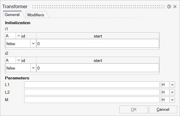

The transformer is a two port. The left port voltage v1, left port current i1, right port voltage v2 and right port current i2 are connected by the following relation:
| v1 | | L1 M | | i1' || | = | | | || v2 | | M L2 | | i2' |
L1, L2, and M are the primary, secondary, and coupling inductances respectively.
mo_i1 | i1 | i1 | Structure | |
mo_i1/fixed | fixed | Cell of scalars | true | |
mo_i1/start | start | Cell of scalars | ||
mo_i2 | i2 | i2 | Structure | |
mo_i2/fixed | fixed | Cell of scalars | true | |
mo_i2/start | start | Cell of scalars | ||
mo_L1 | L1 | Primary inductance | Scalar | |
mo_L2 | L2 | Secondary inductance | Scalar | |
mo_M | M | Coupling inductance | Scalar |

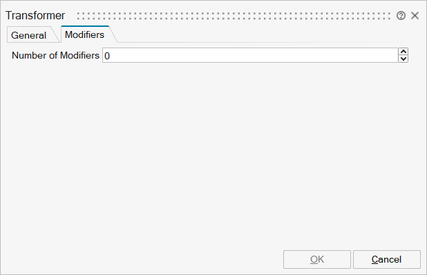

mo__modifiers/varname | Variable name | Cell of strings | 'v1' | |
mo__modifiers/value | Value |
