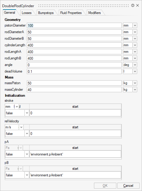

The fundamental geometrical properties of the double rod cylinder are the piston and rod diameters (pistonDiameter, rodDiameterA, rodDiameterB) as well as the lengths of the cylinder and the rod (cylinderLength and rodLength). By using the parameter angle, the inclination of the cylinder with respect to the horizon can be adjusted. The resulting forces due to gravity are taken into account automatically, however without inclusion of static fluid masses.
For dynamic calculations, the masses of the piston and the cylinder are required. These can be provided by specifying the parameters Piston mass and Cylinder mass. The dynamic mass of the fluid, which acts as an additional inertia, is automatically taken into account by the model.

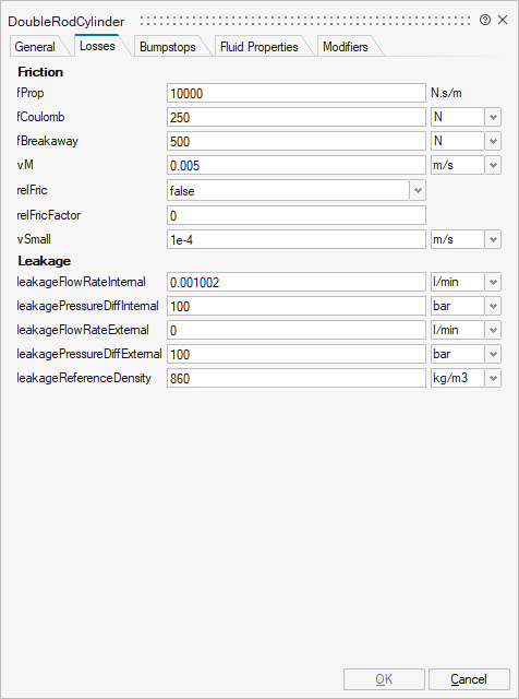

The parameters Breakaway friction force, Constant friction/Coulomb force, Velocity dependent friction and Velocity parameter for Stribeck friction (velocity where the friction force begins to grow linearly) characterize the velocity dependence of the friction force between piston and cylinder. Instead of using the Stribeck friction model, a simplified friction calculation can be enabled by setting the check mark relFric. In this case, the friction force equals the net force acting on the interface between piston and cylinder multiplied by the parameter Relative friction factor. Regardless of which friction model is used, the friction force is not influenced by the inclination of the cylinder or the system pressure. The parameter Relative velocity near to zero is used by the internal state machine of the cylinder model and determines the velocity below which the piston is considered stuck.
The pressure in both cylinder chambers can be initialized by assigning start values to Pressure in chamber A (bore side) and Pressure in chamber B (rod side). The parameter Dead volume determines the size of the parasitic volume which remains even if the piston has reached the mechanical stops at the cylinder ends.

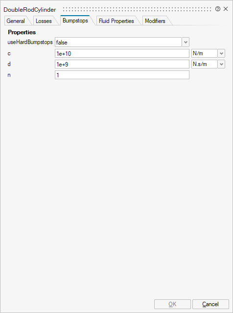

Cylinder ends are modeled as bumstops whose stiffness, damping and stiffness exponent can be tuned in the appropriate Bumpstops parameter tab. Alternatively, the stroke limits can be enforced by means of hard constraints (through useHardBumpstops) thus strictly impeding the cylinder to overextend.
The volumetric losses due to internal and external leakage are parameterized by providing the respective flow rates (Internal leakage: volume flow and External leakage: volume flow), associated pressure drops (Internal leakage: pressure difference and External leakage: pressure difference) and the fluid density Reference density for volume flow and pressure difference for which these values were obtained.

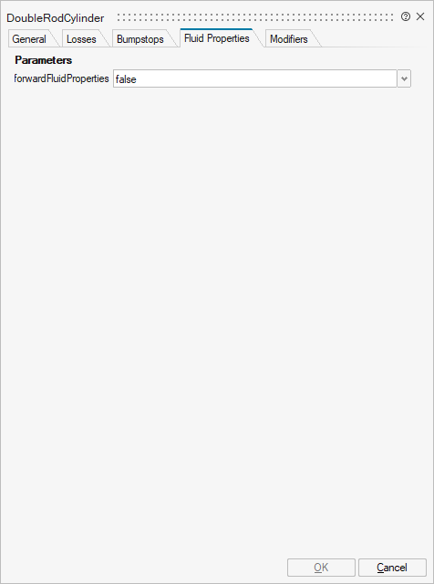

The fluid properties can be propagated between the two hydraulic ports by setting the parameter Forward fluid properties to "true".
mo_pistonDiameter | pistonDiameter | Piston diameter | Scalar | |
mo_rodDiameterA | rodDiameterA | Rod diameter @ port A | Scalar | |
mo_rodDiameterB | rodDiameterB | Rod diameter @ port B | Scalar | |
mo_cylinderLength | cylinderLength | Cylinder length | Scalar | |
mo_rodLengthA | rodLengthA | Rod length @ port A | Scalar | |
mo_rodLengthB | rodLengthB | Rod length @ port B | Scalar | |
mo_angle | angle | Inclination angle | Scalar | |
mo_deadVolume | deadVolume | Dead volume | Scalar | |
mo_massPiston | massPiston | Piston mass | Scalar | |
mo_massCylinder | massCylinder | Cylinder mass | Scalar | |
mo_stroke | stroke | stroke | Structure | |
mo_stroke/fixed | fixed | Cell of scalars | true | |
mo_stroke/start | start | Cell of scalars | ||
mo_relVelocity | relVelocity | relVelocity | Structure | |
mo_relVelocity/fixed | fixed | Cell of scalars | true | |
mo_relVelocity/start | start | Cell of scalars | ||
mo_pA/start | start | Cell of scalars | ||
mo_pB | pB | pB | Structure | |
mo_pB/fixed | fixed | Cell of scalars | true | |
mo_pB/start | start | Cell of scalars |
mo_fProp | fProp | Velocity dependent friction | Scalar | |
mo_fCoulomb | fCoulomb | Constant friction/Coulomb force | Scalar | |
mo_fBreakaway | fBreakaway | Breakaway friction force | Scalar | |
mo_vM | vM | Velocity parameter for Stribeck friction | Scalar | |
mo_relFric | relFric | Use "relative friction factor" to calculate friction | Scalar | true |
mo_relFricFactor | relFricFactor | Relative friction factor | Scalar | |
mo_vSmall | vSmall | Relative velocity near to zero | Scalar | |
mo_leakageFlowRateInternal | leakageFlowRateInternal | Internal leakage: volume flow | Scalar | |
mo_leakagePressureDiffInternal | leakagePressureDiffInternal | Internal leakage: pressure difference | Scalar | |
mo_leakageFlowRateExternal | leakageFlowRateExternal | External leakage: volume flow | Scalar | |
mo_leakagePressureDiffExternal | leakagePressureDiffExternal | External leakage: pressure difference | Scalar | |
mo_leakageReferenceDensity | leakageReferenceDensity | Reference density for volume flow and pressure difference | Scalar |
mo_useHardBumpstops | useHardBumpstops | Enforce hard limits on stroke instead of bumpstops | Scalar | true |
mo_c | c | Bumpstops spring constant | Scalar | |
mo_d | d | Bumpstops damping constant | Scalar | |
mo_n | n | Exponent of bumpstops spring force ( f_c = -c*|s_rel-s_rel0|^n ) | Scalar |
mo_forwardFluidProperties | forwardFluidProperties | Forward fluid properties between ports | Scalar | true |

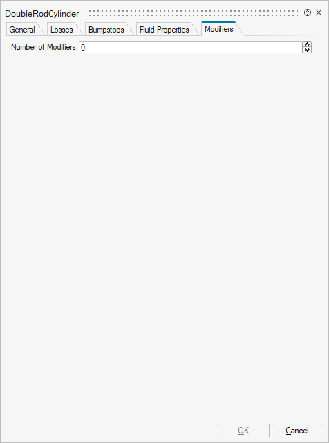

mo__modifiers/value | Value |
