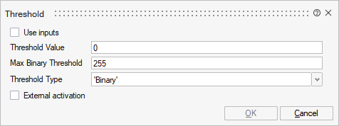

useInput | Use inputs | Use inputs to define the Threshold Value and the Max Binary Threshold. | Number | 0 |
thresholdValue | Threshold Value | Indicates the minimum pixel value (0 – 255) for the threshold operation. | Scalar | |
maxBinaryValue | Max Binary Threshold | Indicates the maximum value (0 – 255) of the pixel for the threshold operation. | Scalar | |
thresholdType | Threshold Type | Binary: If the source pixel value is greater than the threshold value, the new pixel value is set to the specified Max Binary Value; otherwise, the pixel value is set to 0. Binary Inverted: If the source pixel value is greater than the threshold value, the new pixel value is set to a 0; otherwise, the pixel value is set to the Max Binary Value. Threshold to Zero: If the source pixel value is greater than the threshold value, the new pixel value is set to 0; otherwise, the pixel value is set to the source pixel value. Threshold to Zero Inverted: If the source pixel value is greater than the maximum threshold value, the new pixel value is set to 0; otherwise, the pixel value is set to the source pixel value. Threshold Truncated: If the source pixel value is greater than the threshold value, the new pixel value is set to the threshold; otherwise, the pixel value is set to 0. | String | 'Binary' |
externalActivation | External activation | This parameter defines if the block receives or inherits an external activation. When External Activation is used, an additional activation port is added to the block. Default is OFF. | Number | 0 |
