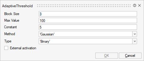

AdaptiveThreshold
The AdaptiveThreshold block creates a binary image by classifying each pixel as either dark or light based on whether its intensity value is above or below the specified threshold.
ComputerVision/Images/Transformations/Misc
blockSize | Block Size | Indicates the matrix size of the pixel neighborhood used to calculate a threshold value for a pixel. | Scalar | |
maxValue | Max Value | Scalar | ||
constant | Constant | Indicates a constant value subtracted from the mean or weighted mean. Specify the constant as an integer. | Scalar | |
method | Method | Gaussian: Indicates that the threshold value T(x,y) is a weighted sum (cross-correlation with a Gaussian window) of the pixel neighborhood of (x,y) minus the specified constant. Mean: Indicates that the threshold value T(x,y) is the mean of the pixel neighborhood of (x,y) minus the specified constant. | String | 'Gaussian' |
type | Type | Indicates the thresholding type. There are two choices: Binary and Binary Inverted. | String | 'Binary' |
externalActivation | External activation | This parameter defines if the block receives or inherits an external activation. When External Activation is used, an additional activation port is added to the block. Default is OFF. | Number | 0 |
