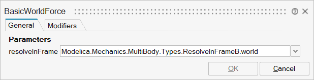

The 3 signals of the force connector are interpretedas the x-, y- and z-coordinates of a force acting at the frameconnector to which this component is attached.Via parameter resolveInFrame it is defined, in which frame thesecoordinates shall be resolved:
| Types.ResolveInFrameB. | Meaning |
| world | Resolve input force in world frame (= default) |
| frame_b | Resolve input force in frame_b |
| frame_resolve | Resolve input force in frame_resolve (frame_resolve must be connected) |
If resolveInFrame = Types.ResolveInFrameB.frame_resolve, the force coordinatesare with respect to the frame, that is connected to frame_resolve.
If resolveInFrame is not Types.ResolveInFrameB.frame_resolve, then the positionvector and the orientation object of frame_resolve must be set to constantvalues from the outside in order that the model remains balanced(these constant values are ignored).
mo_resolveInFrame | resolveInFrame | Frame in which force is resolved (1: world, 2: frame_b, 3: frame_resolve) | Structure | |
mo_resolveInFrame/choice1 | Modelica.Mechanics.MultiBody.Types.ResolveInFrameB.world | Number | 0 | |
mo_resolveInFrame/choice2 | Modelica.Mechanics.MultiBody.Types.ResolveInFrameB.frame_b | Number | 0 | |
mo_resolveInFrame/choice3 | Modelica.Mechanics.MultiBody.Types.ResolveInFrameB.frame_resolve | Number | 0 |
