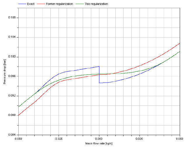

Partial Model Modelica.Fluid.Pipes.BaseClasses.FlowModels.PartialGenericPipeFlow
This model describes pressure losses due to wall friction in a pipe and due to gravity. Correlations of different complexity and validity can be selected via the replaceable package WallFriction (see parameter menu below). The details of the pipe wall friction model are described in the UsersGuide. Basically, different variants of the equation
dp = λ(Re,Δ)*(L/D)*ρ*v*|v|/2.
By default, the correlations are computed with media data at the actual time instant. In order to reduce non-linear equation systems, the parameters use_mu_nominal and use_rho_nominal provide the option to compute the correlations with constant media values at the desired operating point. This might speed-up the simulation and/or might give a more robust simulation.

This component defines the complete regime of wall friction. The details are described in the UsersGuide. The functional relationship of the friction loss factor λ is displayed in the next figure. Function massFlowRate_dp() defines the "red curve" ("Swamee and Jain"), where as function pressureLoss_m_flow() defines the "blue curve" ("Colebrook-White"). The two functions are inverses from each other and give slightly different results in the transition region between Re = 1500 .. 4000, in order to get explicit equations without solving a non-linear equation.
Additionally to wall friction, this component properly implements static head. With respect to the latter, two cases can be distinguished. In the case shown next, the change of elevation with the path from a to b has the opposite sign of the change of density.
In the case illustrated second, the change of elevation with the path from a to b has the same sign of the change of density.
