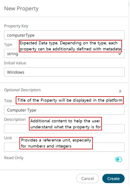

  3. Set the following:
    1. Property Key: the title of the property
    2. Type
    3. Initial values: optional parameters
    4. Optional Descriptors such as description, unit or type read-only.
    Figure 3. New Property form
