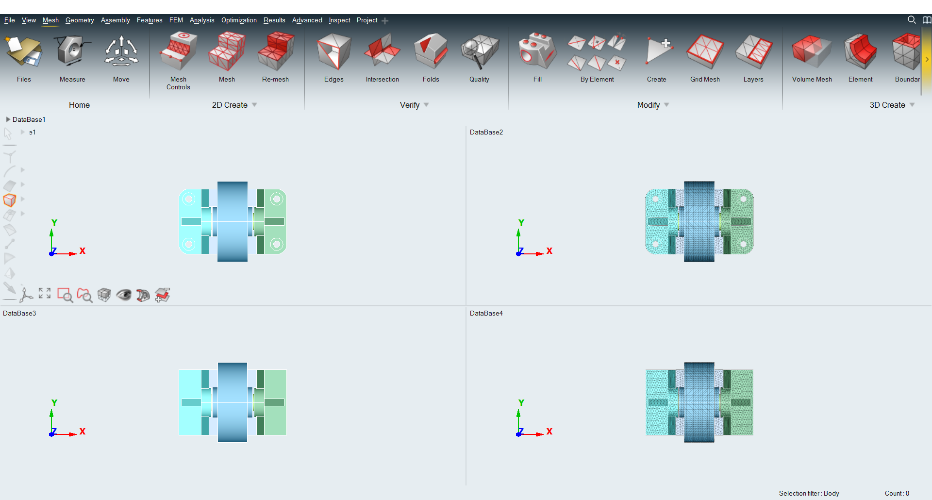

The modeling window includes a flexible layout and navigation system that lets you create multiple windows and view. Also allows to review and compare multiple databases at the same time. Select and move the horizontal or vertical separators as needed to make the window larger or smaller.
The active database will have the vertical tool list and bottom tool bar.
After tile, you can select one of the databases and navigate through the various databases. In the tile mode, user cannot see the tabs at the bottom to switch to another database.
Layout is used to lay out the databases.You can split the modeling window horizontally or vertically in a layout.
Each database will have the maximize and close buttons.

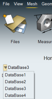

Lists the saved databases using "File|Preferences|Application|Auto Save" with time stamp information in the navigator bar right click.It will have close button to close the database and duplicate button to duplicate the database
