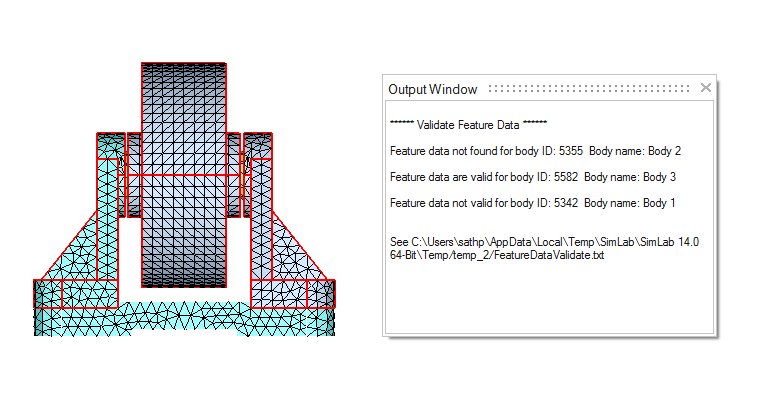

This option is used to validate attributes of FEM bodies.
Attributes that will be validated are
  • Arc
  • Circle
  • Cylinder
  • Cone
  • Torus
  • Sphere
If the attributes are not valid, text file containing the entities with wrong attributes will be written in temp directory. The location of the file will be written in output window.
Example
