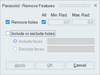

Holes in the parasolid file can be removed using this option. All the holes can be removed or holes between certain range can be removed. Also there is an option to include / exclude certain holes to remove.
Note: Remove holes is not supported for Parasolid model imported with "Save geometry in database" option enabled.

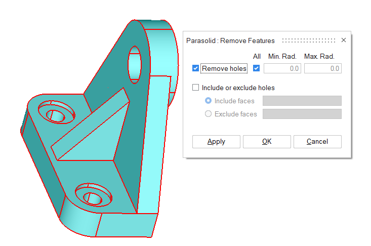

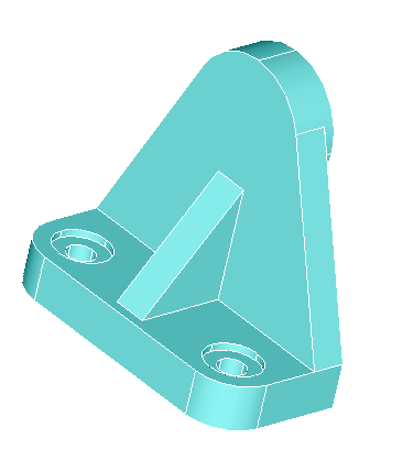

Example 1: Remove All Holes
In the example below, all the holes in the parasolid are removed.

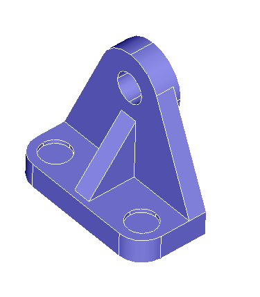

Before Parasolid Feature Removal
After Parasolid Feature Removal

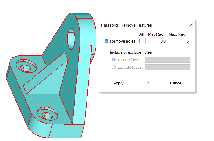

Example 2: Remove Holes between ranges
In the example below, all the holes in the radius range 0 to 5 are removed.

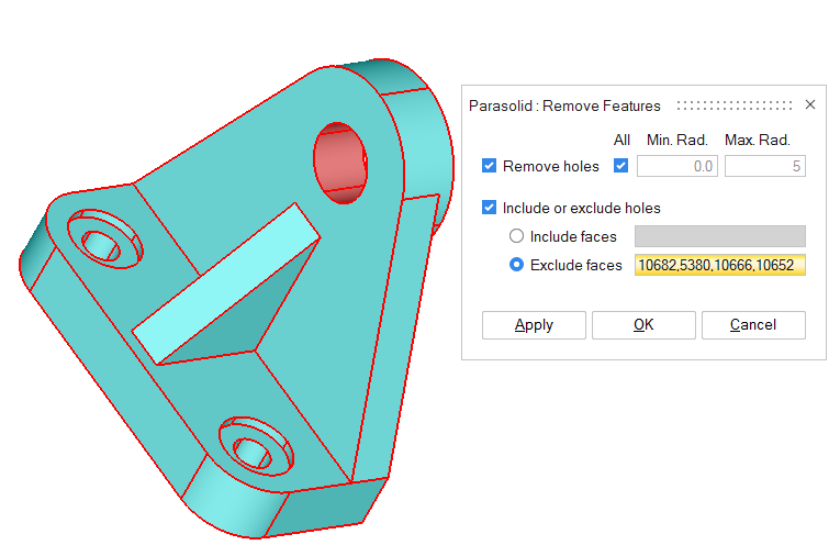

Example 3: Exclude holes to Remove
In the example below, the holes that are selected under exclude will not be removed and all other holes will be removed.
