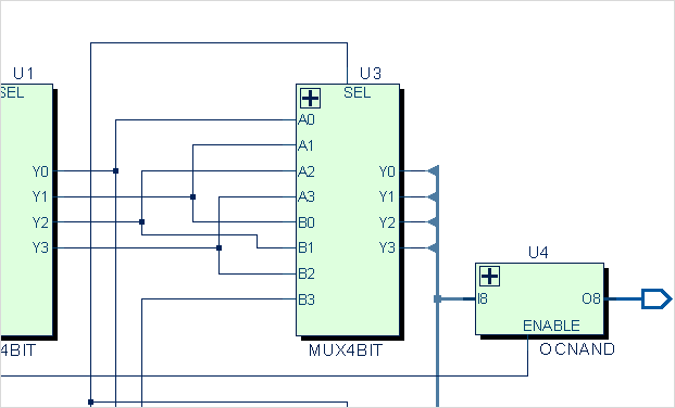

To overwrite a box with a nice symbol shape the name of the symbol must match the name of the module. Here is an example of the gl85 design which can be found in the demo directory.
In the Schem window you can see a box for the module MUX4BIT:
Now you can provide a symbol library file to RTLvision PRO in the file open dialog or on the command line. Here is an excerpt of a symlib file:

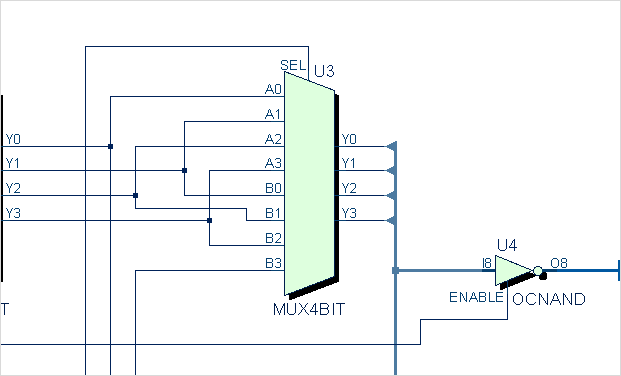

    fpath 0 -10 0 -100 40 -80 40 -30 0 -10
Now you can see the symbol shape in the Schem window.
