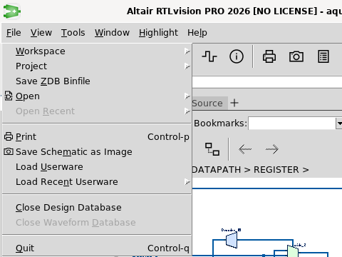

You can access the dialog to open files through the menu:
Or by using the corresponding open icon in the toolbar:
or this icon
to show the 'Open File' dialog.
