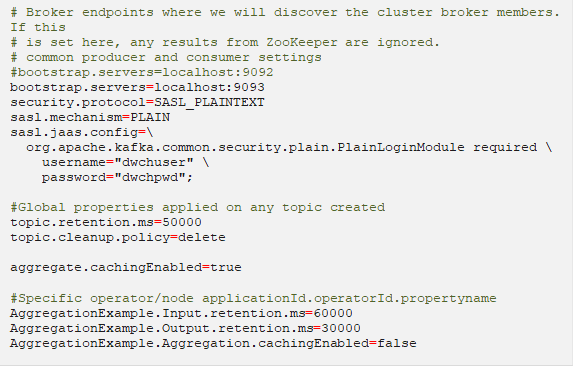

The user-defined Kafka.properties  file contains properties for controlling the Kafka configurations in Panopticon Streams.
Below is a sample properties file:

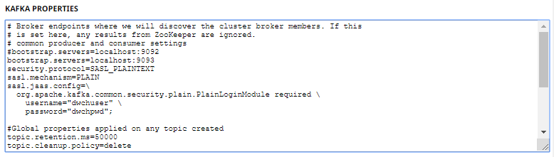

When Panopticon Streams is started, it checks the AppData folder for the kafka.properties  file and loads the properties in the Kafka Properties box.

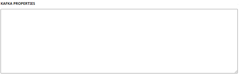

However, if the kafka.properties file is not available, the Kafka Properties box will display as blank:

  • The values in the Kafka Properties box is not editable on the System tab. Changes can be made in the actual kafka.properties file. To reload the properties on the System tab, click Reload Configuration.
  • The kafka.properties file supports any Kafka configurations available on their documentation
  •  The configurations made in the kafka.properties will supersede any of the Kafka-related
    properties in the Streams.properties file
  • Some of the configurations in the kafka.properties file can be overridden by the settings made in Panopticon Streams applications
