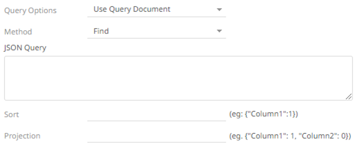

  3. To make the Query Document feature of MongoDB available in Panopticon, select Use Query Document.
    The Plugin Settings pane updates to display the settings of this query option.
    For the Method option, select any of the following values:
    • Find (Default)
      Allows you to fetch a document from a MongoDB collection.
      Two more configurable settings are available:

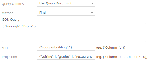

      NOTE: _id field is always displayed while executing the Find method. You can opt to set this field to 0 to hide it (e.g., {"_id":0}).
      • Sort
        Provide a JSON object that defines the sort criteria, then set the order to either 1 for ascending or -1 for descending (e.g., {"address.building":1}).
      • Projection
        Provide a JSON object to include or exclude from the result of the Find query.
        For example, if a document has 9 documents and you only need to display 5, you can either:
        • select 5 JSON objects, then set the limit value to 1 to display
          {"cuisine":1, "grades":1, "restaurant_id":1, "name":1, "borough":1}
        • select 4 JSON objects then set the limit value to 0 to hide
          {"address.zipcode":0, "address.coord":0, "address.street":0, "address.building":0}

    For example, queries from the document look like this: db.inventory.find ( {type:"snacks"} ). The database and collection are already defined in the UI and the Find operation is handled in the code. You only need to enter the JSON query:
    {"type":"snacks"}
