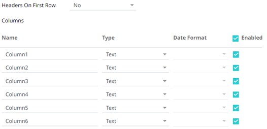

  4. Adjust the Headers On First Row if needed. By default, the connector will pick up headers from the first row if all cells on the first row contain text data.
    You can opt to select one of the following:
    • Leave headers on first row as Auto if you want the connector to automatically pick up column names from sheet.
    • Select Yes to force picking first row as headers.
    • Select No to force not picking first row as headers. This will auto generate all column names.
