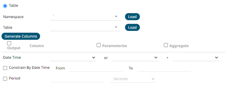

- When Table is selected, the section below is enabled:
The Namespace drop-down is an editable combo box.
You can either:
- Click
and select a namespace from the list of all root level namespaces. By default, the selected namespace will be root (backtick `). - For nested namespaces, enter them in the Namespace box (e.g., panopticon.test) to get the tables that were created under these namespaces.
- Click
- On the Table field, click
to populate the drop-down list with tables and views. Select a table or view. - Click
. The columns of the selected table or view populates the Output Column section. - Individual columns can be added by selecting the corresponding Column checkbox in the Output Column listing.
- If the data returned is to be aggregated, then the Aggregate checkbox should be selected. For each selected column, the possible aggregation methods are listed including:
- Text Columns: Group By
- Date Columns: Count, Min, Max, Group By
- Numeric Columns: Sum, Count, Min, Max, Group By
In addition, the qSQL query is generated and displayed on the Query text box.
- Select the Parameterize checkbox and match the parameter to the appropriate column. By default, they will be matched by name.
The appropriate qSQL query is updated on the Query text box. This shows the default parameter value for the preview, and at run time the qSQL will be updated to whatever the parameter value is.
- If the data is to be filtered or aggregated on Date/Times, then a valid Date Time field needs to be selected from either a single Date/Time field, or a compound column created from a selected Date and a selected Time column.
- Select the Constrain by Date Time checkbox and enter From and To Date/Time constraints.
- In Kx kdb+, you can modify the query to regroup the aggregated data per time units (i.e., Seconds, Minutes, Hours, Date, Week, Month). Select the Period checkbox, enter the time duration and click
then select the time unit. - Click the Query radio button to enable the text box and modify the qSQL query language.
