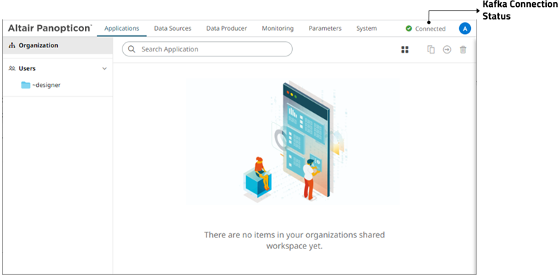

NOTE: Panopticon Streams Server will be connected to the CEP engine after start up if any of the following settings is true:
  • The default setting of the localhost for the Kafka broker is available.
  • The Kafka settings in the Streams.properties file are correct.

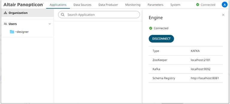

Click Kafka Connection Status to expand and display the Engine pane and view the settings.
For :
For :
Property Description
Status
Displays whether Panopticon Streams is connected to or disconnected from the CEP Engine (Kafka).
Type
The CEP Engine that Panopticon Streams engine will work with (KAFKA).
ZooKeeper
The URL to the ZooKeeper servers. Default is localhost:2181.
Kafka
The URL of all the Kafka servers. Default is localhost:9092.
Schema Registry
The URL to the Schema Registry. Default is http://localhost:8081.
