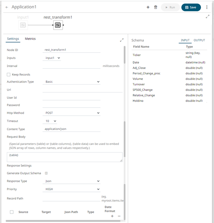

  1. On the Application page, click   and select Rest_Transform   in the Add Operator pane.
    The REST Transform node  icon displays in the Graph pane, as well as the properties to be defined in the Operator Settings pane, and the preview of the data in the Schema pane.
    The right (outbound) edge allows you to connect to the other operators.
  2. In the Operator Settings pane, define or select the following required properties:

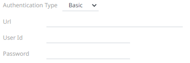

    • Basic
      Enter the URL of the REST API. Then enter the User Id and the Password that will be used to the connect to the REST API.

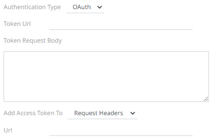

    • OAuth
      Then enter the following settings:
      • Token URL – The URL to retrieve the access token from.
      • Token Request Body – The request body used for access token requests.
      • Add Access Token To - The Access token retrieved from the Token URL can be added to headers, URL or request body, depending on how the REST endpoint needs the token.
        • Request Header - A header is automatically added to the REST API request.
        • Request URL - The URL needs to be manually parameterised with a {access_token} parameter, before calling the REST API, the parameter is replaced with the actual token.
        • Request Body - The Request Body needs to be manually parameterised with a {access_token} parameter, before calling the REST API, the parameter is replaced with the actual token.

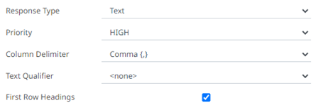

  5. Select the Response Type:
    • XML
    • JSON
      If JSON is selected, enter the Record Path which allows the identification of multiple records within the JSON document.
    • Text
      If Text is selected, confirm the Column Delimiter, Text Qualifier, and if the first row of the message includes column headings.
  6.  Select the Priority of the node’s startup:
