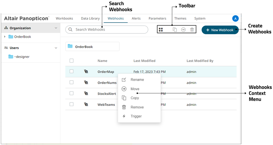

Property Description
Search Webhooks
Entering text will filter the webhooks.
Toolbar
Allows you to copy, move, and remove webhooks.
Also, to display the webhooks list either on List View or Grid View.
Create Webhooks
Allows you to create new webhooks.
Webhooks Context Menu
Allows you to rename, move, copy, delete, and enable the trigger of webhooks.
