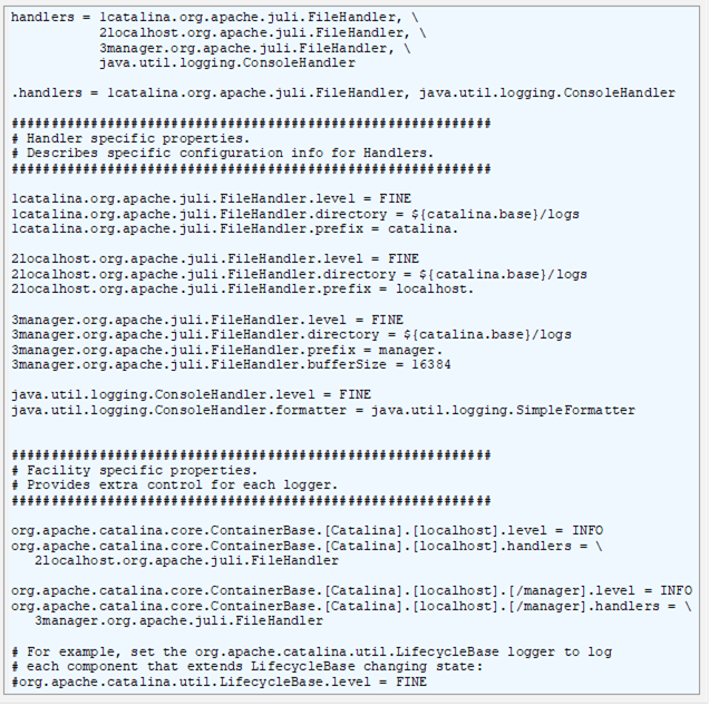

Example logging.properties file to be placed in $CATALINA_BASE/conf:

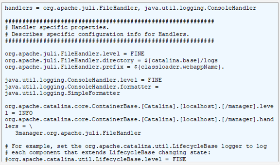

Example logging.properties for the servlet-examples web application to be placed in WEB-INF/classes inside the web application:
