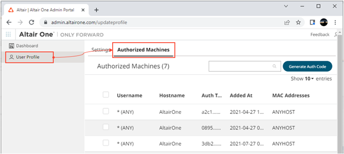

- Log on to Altair One (https://admin.altairone.com) then navigate to User Profile and select Authorized Machines.

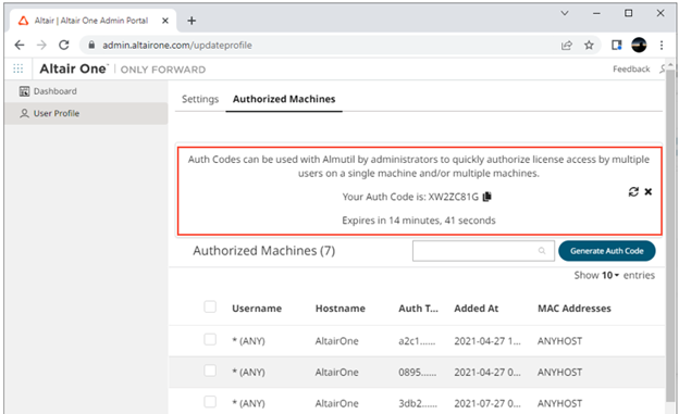

- Click
The page displays the auth code and a timer indicating the code’s expiration.
Click Copy to Clipboard
to copy the generated auth code. - Paste the generated code into the license.hwu.hosted.authorization.authcode property in the Panopticon.properties file.
