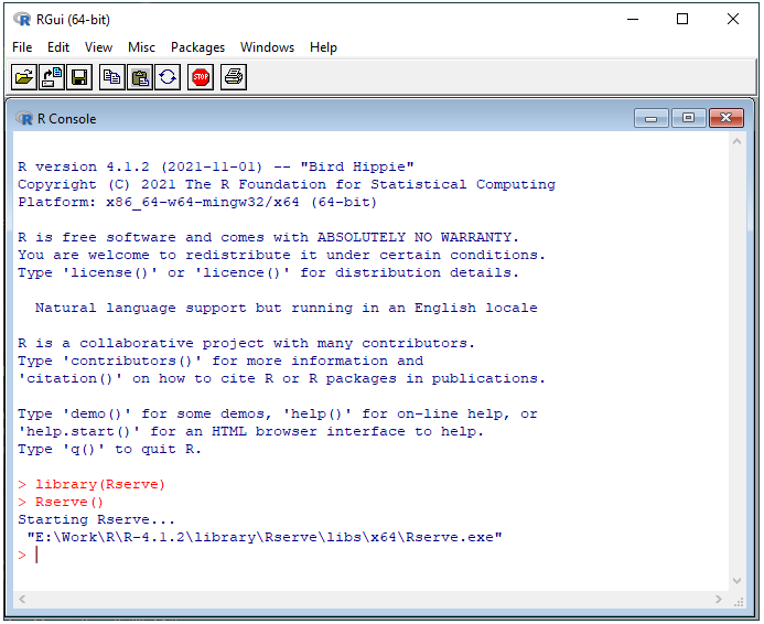

 - Initiatiate the Rserve library using the following command:
library(Rserve)
 - Run Rserve by executing the following command:
Rserve()
Only steps 2, 4 & 5 need to be repeated when R connectivity is required.
Example:
NOTE: Connectivity by default is over Port 6311.
