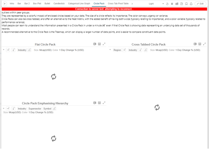

A notification message displays such as below. Clicking the Reconnect link will attempt to reconnect to the server.

A notification message displays such as below. Connection to server lost: attempting to reconnect…
