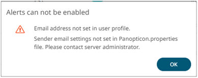

Otherwise, when trying to enable an alert, this error will be displayed:
Save the updated file and restart Tomcat.
