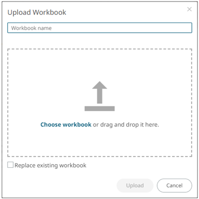

- On the Workbooks page, click on a folder or subfolder and select Upload Workbook.
The Upload Workbook dialog displays.
- To upload a workbook, you can either:
- Drag it from your desktop and drop on the dialog, or
- Click Choose Workbook and select one on the Open dialog that displays.

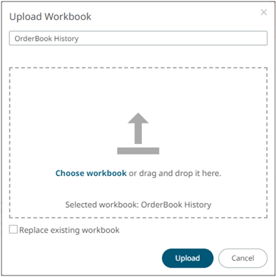

The name of the workbook is displayed on the uploaded workbook area and in the Name box.
- You can rename the workbook.

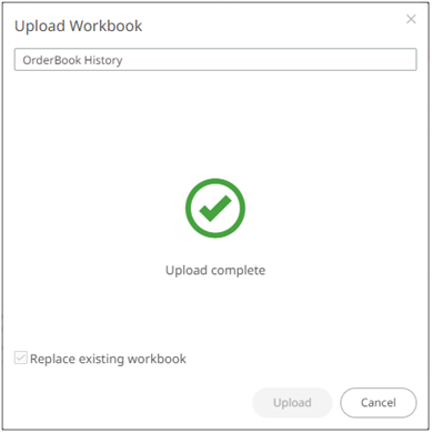

- To replace an existing workbook, select the Replace existing workbook checkbox.
- Click
You will be notified once the workbook is uploaded.
The workbook is added and displayed.
