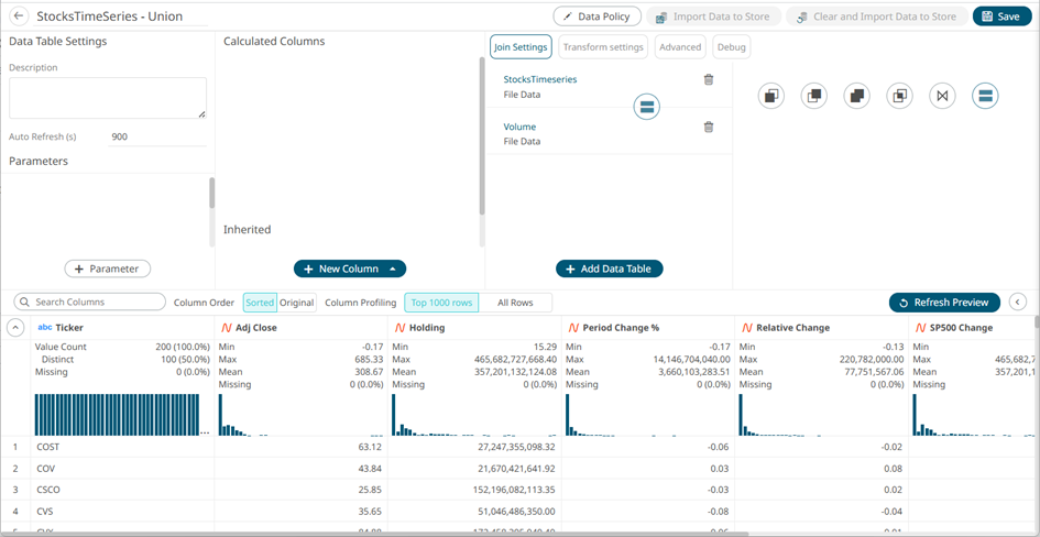

- To join the data sources, click the Join
button.
The Join Settings pane displays.
- Select Union All
then click
All the result of the union all is displayed in the Data Source Preview.
- Click
. Once saved, a notification displays.
