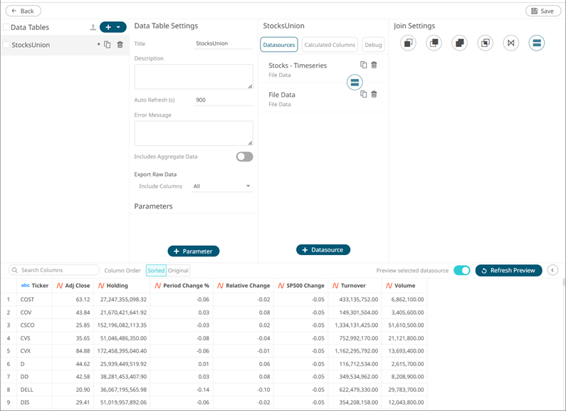

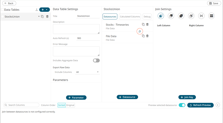

- To join the data sources, click the Join
button.
The Join Settings pane displays.
- Select Union All
then click
All the results of the union are displayed in the Data Source Preview.
