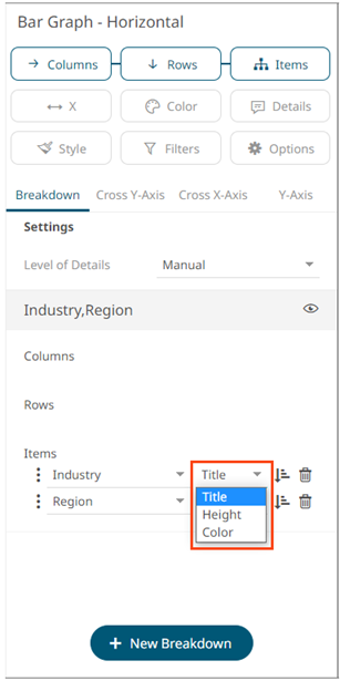

Sorting Visualization for Each Level of the Breakdown
You can sort visualizations based on the filled variables, plus alphabetically on the breakdown title.
For example, here are the available sorting methods for the Bar Graph – Horizontal visualization:
NOTE: These sorting options are also available on the Breakdown column and Pivot point context menu:
  • Sorting by Title (Default)
    Sorting based on the breakdown column name values, in ascending order.
  • Sorting by Height
    Sorting based on the height (X) variable values (eg., Mcap(USD).
    This type of sorting is most useful in the following visualizations:
    • Bar Graphs
    • Treemaps (to produce a Heat Map)
    • Stack Graphs
    • Horizon Graphs
    • Sorting by Color
    Sorting based on the color variable values (e.g., 1 Month Change % (USD)).
Sorting the Visualization Based on the Breakdown Column Values
Sort the visualization in an Ascending   or Descending   order by clicking on a breakdown level Sort icon.
