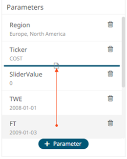

The order of the data table parameters in the Data Table Editor layout can be rearranged.
  1. Click the parameter you want to move.
    The Hand Hover  icon displays along with the blue marker before or after a data table parameter where
    you can drop the item.
  2. Drag and drop the parameter to the desired position.
  3. Click the Save   button.
    When saved, the notification displays.
