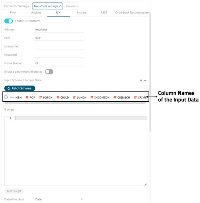

When the R button is selected, the Transform Settings pane changes to show:
  1. Tap the Enable R Transform slider to turn it on.
    The Transform Settings button and R tab change to  and , respectively. The default Address (i.e., localhost) and Port (i.e., 6311) fields are displayed.
  2. Specify the Username and Password if authentication is enabled on the Rserve process.
    NOTE: The Address, Port, Username, and Password fields will be hidden if their corresponding properties are set in the Panopticon.properties file.

  3. The Frame Name that Panopticon will produce and then be utilized by the R scripts should be specified. Default is df.
  4. Specify whether to Enclose Parameters in Quotes.
  5.  On the Input Schema/Sample Data section, the column names of the input data source are displayed. You can opt to add sample data to ensure transform is applied in case the input database, files, or infrastructure becomes unavailable.

  6. Enter the R Script. This R script should reference the input frame name and return a data frame. Just like an underlying SQL query, the R Script itself can be parameterized.
    NOTE: This step will work for small and simple use cases. However, when you have several transforms, or when each transform is applied to several data tables, it is highly recommended to follow the instructions in the Best Practices on Working with R Transform in Panopticon section.
  7. Click  . If successful, the output schema is displayed.
    Otherwise, a notification is displayed with the cause of the error. Update the script.
