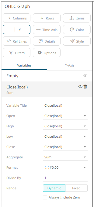

- On the Visualization Settings pane, click the Y (OHLC) variable. To associate other columns from the data table, drag and drop them to the OHLC variable drop area. Select one to display the corresponding configuration pane.
- Enter the label of the OHLC variable in the Variable Title field.
You can parameterize the variable title to support dynamic schema in the dashboards.
- Unlike other variables, the OHLC requires four input columns (Open, High, Low, and Close). These can be selected from list boxes once the Close column has been dragged onto the OHLC variable slot.
- You can also specify an aggregation method in the Aggregate field.
The default is Sum.
The OHLC variable also supports several other aggregate types:

- The Format field lets you specify the format that numbers will be displayed in. Panopticon uses the same formatting rules as Excel.
- Select the Divide By value to divide a number:
- 1
- 1000 (by a thousand)
- 10000
- 1000000 (by a million)
- 1000000000 (by a billion)
- The visible range for the OHLC variable can be calculated dynamically (the default, enabled Dynamic).
Select the Always Include Zero checkbox to let the axis scale start at zero and grow to any number that may show up in the data.
Or set between predefined limits by clicking Fixed. This reveals the Min and Max text boxes and populates them with default values taken from the data set.
