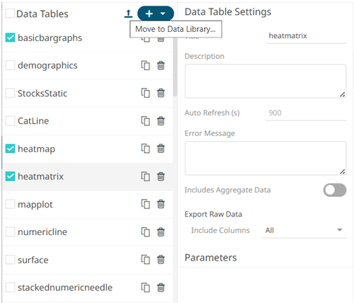

- Select one or more data tables checkboxes in the Data Tables list then click Move to Data Library.
The Move to Data Library dialog displays.

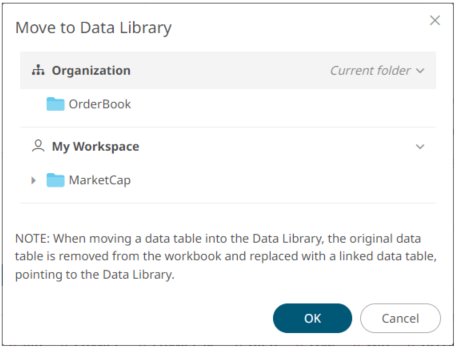

- If one data table was selected, you can enter a new Name for the published data table template.
- However, if several data tables were selected, this is the dialog that displays.
- 2. Select the folder or subfolder where the data table template will be published.
- Click
The moved notification message displays.
NOTE:
- The published data tables are removed from the Data Tables pane in the Workbook Internal Data Table Editor.
- The original data tables are removed from the workbook and replaced with a linked data table, pointing to the data library.
