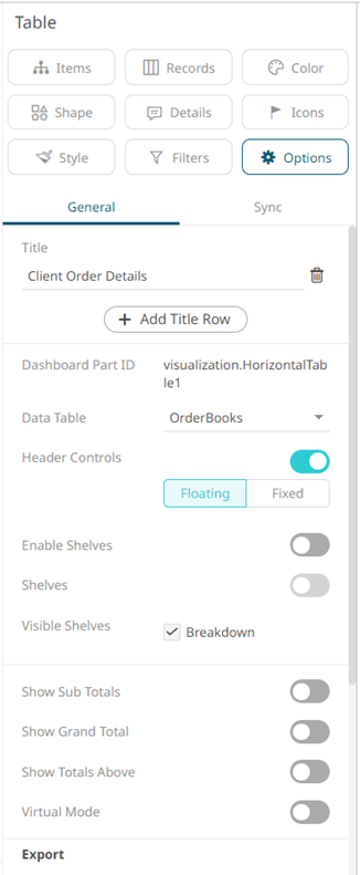

  2.  Click the Options   button. The Visualization Settings pane is displayed along with the current data table being used. For example:
  3. Select another data table in the Data Table drop-down list.
    The visualization is updated to reflect the data setting in the new associated data table.
