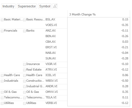

Sample 1
Below is the defined breakdown in a Table visualization:

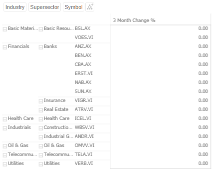

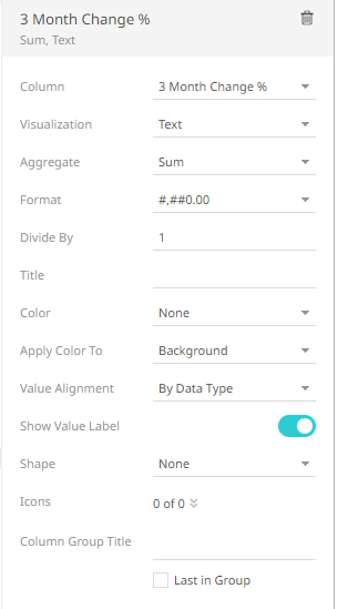

This Table visualization is showing the grouping of the columns based on the breakdown hierarchy with 3 Month Change %’s aggregate set to Sum.
Changing the aggregate to Level and the format to #,##0.00 will produce this table since the Visible Depth is set until Symbol:
Sample 2
Clicking on Supersector will make the Symbol breakdown column invisible:

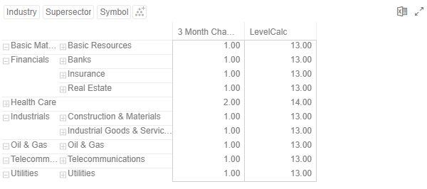

Collapsing columns in the table can also change the Level values:
Sample 4

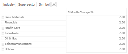

Clicking to the Root in the breakdown hierarchy:

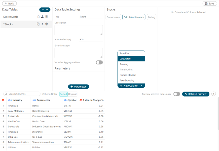

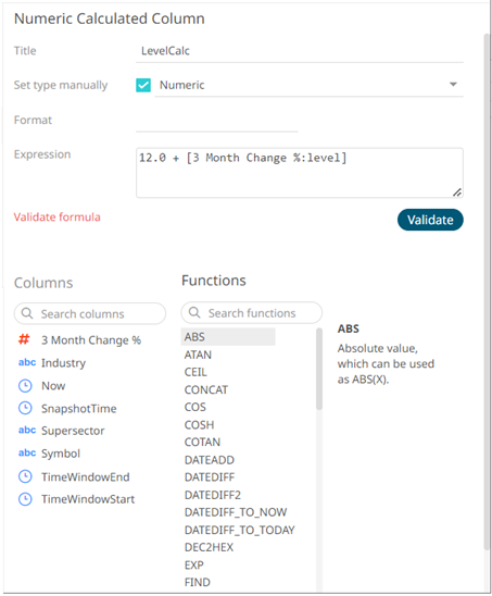

The Level aggregate can also be used when creating calculated columns.
- On the Data Table Editor layout page, click Calculated Columns and select Calculated.

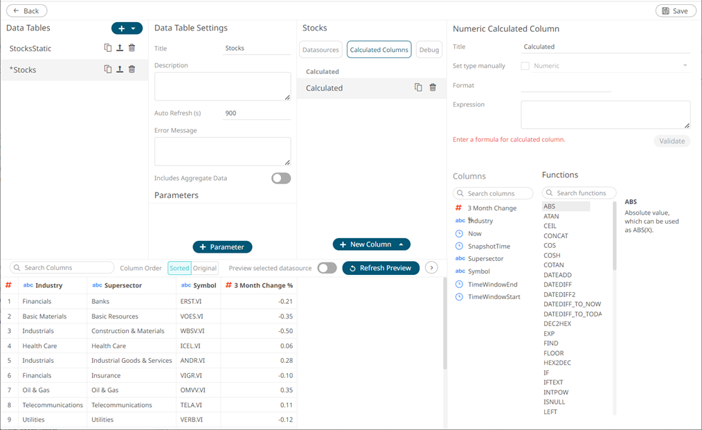

The Numeric Calculated Column pane displays.
 - Build the expression with the Level aggregate.
For example: 12.0 + [3 Month Change %:level]
When all of the levels are visible in the breakdown (Sample 1), the results will be:
