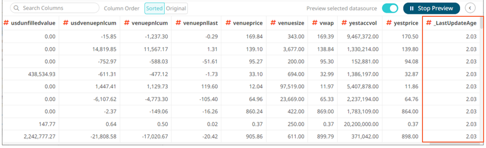

    In the Data Sources Preview window, two columns are added:
    • _LastUpdateTime - Date/Time column which updates on all rows that were inserted or updated.
    • _LastUpdateAge - Numeric column which represents the seconds since rows were last touched in a flush. This is updated on all rows.
