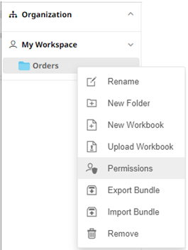

  1. Right-click on a folder and select Permissions in the context menu.
    The Permissions dialog displays.

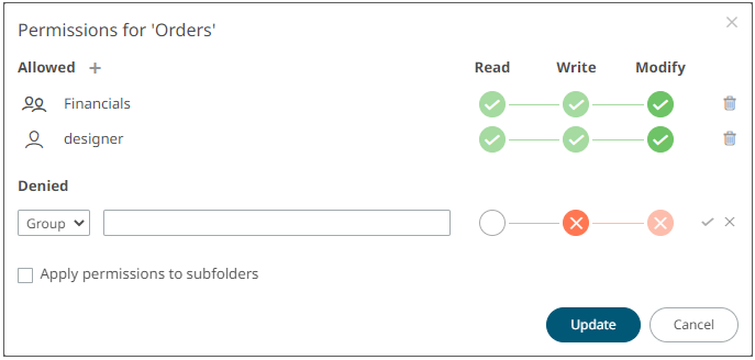

  2. Under the Denied section, click the Add   icon.
    A new User/Group Denied section is displayed.

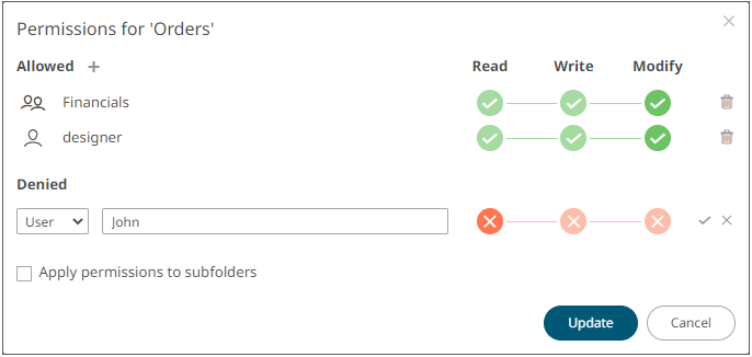

  3. Select User or Group that will be given denied permission in the drop-down list.
  4. Enter the user or group Name.
  5. Select the permission level that will be granted to the user or group:
    • MODIFY
      Prevent user or group to modify and create subfolders.
    • WRITE + MODIFY
      Prevent user or group to modify and write to the folder.
    • READ + WRITE + MODIFY
      Prevent user or group to modify and create subfolders, modify and write to the folder, as well as read the folder.
  6. Click  . The user or group is added under the Denied list.
    Repeat until all of the users with denied access are added.
  7. Click   to save the changes.
