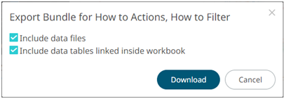

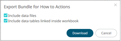

  1. You can do one of the following:
    • Select one or several workbooks, then right-click or click More Actions  and select Export bundle in the context menu, or

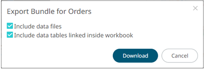

    • Right-click on a folder and select Export Bundle in the context menu.
    A notification message displays.
    For one or several workbooks:
    For a folder:
    Export Option Description
    Include data files
    The associated workbook data files will be included in the download.
    Include data tables linked inside workbook
    The associated data tables linked inside workbooks will be included in the download.
  2. Click  .
